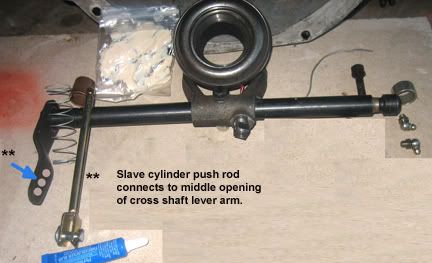

Brent: Here is a photo of the insides of
the tranny case showing the cross shaft, slave
cylinder push rod, throw out bearing, bearing fork,
bushings, etc.
Make sure you connect the push rod to the middle
hole of the cross shaft lever arm. Also, you might
have to add steel washers as shims to the slave cylinder
mounting bolts to get the push rod centered over the
middle hole.

Tinster-the cross shaft lever arm (with the slave disconnected) only moves about an inch total. should it move more? it hits something solid when you go either direction.
