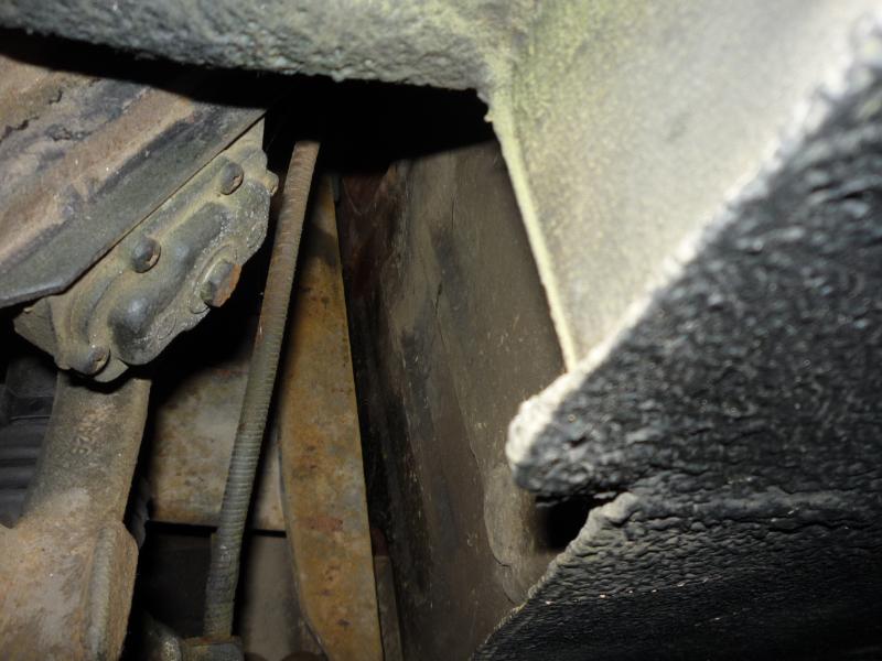

One unusual thing to check is the handbrake cables. They run over the top of the frame (diff mount part) and can move vertically and contact the underside of the body in the rear shelf area. I just took a picture looking forward from behind the pass rear wheel; you can see the cable forward of the shock. Push it up and down to see if it reproduces your sound. The cable doesn't have much mass, but the right bump might bounce it up and down a bit. The factory put a rubber casing over part of the cable to cushion it some. P1090379.jpg

I don't think a handbrake cable would make such a loud knock. This is loud. Doesn't sound good. I'll have someone else drive the car and listen. Cracked frame? Maybe. I'd have to pull off a wheel to check, and that's a problem - I can't lift the heavy wheel and tire back on the hub any more - bad back and who knows what else. Would it show up on a lift with the suspension hanging down or would the wheel have to be jacked up to expose any crack since I only hear it going over bumps?

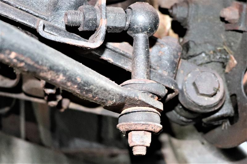

Follow up. I don't have a rear sway bar, but the noise is similar to one I had from a bad front sway bar bushing in my 1984 Audi Quattro, but that noise was when I turned the wheel and put stress on the bar.
Update. I tried to remove RR wheel to examine mounts but was unable to. The centerlock nut? whatever you call it - was too tight and actually bent my longer wrench when I stood on it and I was unable to hammer it loose with my short wrench so I jacked it up, shoved a jackstand underneath and crawled under with my miners light. From my limited view, everything looked fine. The diff rubber (poly?) bushings looked fine although I was unable to see what lay underneath and probably wouldn't be able too unless the diff was unbolted and dropped away. There was no obvious crack near the top shock mount. What I did see was the exhaust pipe actually resting against the frame where it went through and it looked pretty close as well further up- maybe close enough to hit when going over a bump. All clamps and hangers are tight. Question - does the exhaust pipe change position when hitting a bump or does it move as one with the frame? The noise does sound like it's coming under the rear of the passenger seat.

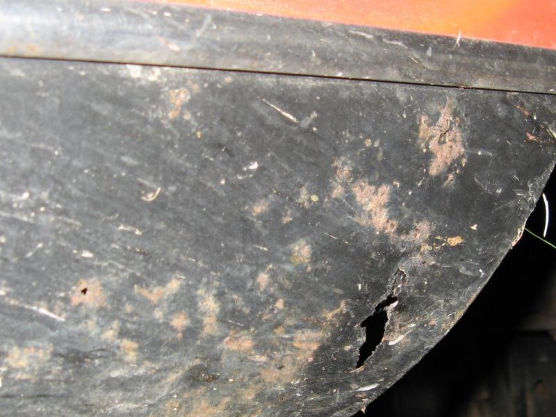

While under there on my new creeper, I tightened the rear brakes and examined the rest of the car. The only rust was on the right side rocker panel with one small hole. The entire frame and floors were solid and free from any rust. The front sway bar end bushings were shot and the tie rod rubber bushings looked a bit tired as well. I did notice a very small amount of play in the left rear wheel-maybe a few mms. Is this anything to worry about? The right hub was replaced a few years ago. No play at all.
