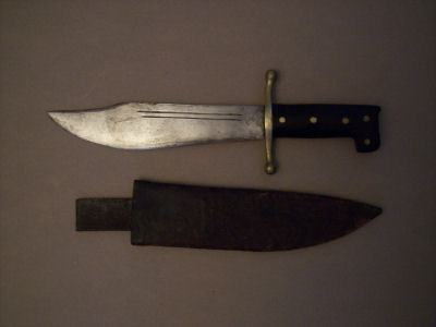

Thank you all for the replies. It is all for naught, however. Shamefully, the knife in question has sat on my shelf for years, and I never looked at the blade. Family legend had it being made of old Japanese fighter plane ally-a souvinir, mind you, not for cutting. Here it is in it's usual home:
And here it is on the table:
Where you can clearly see that the blade is steel, not ally. I will admit that I never inspected it closely, and I've had the thing for close on twenty years-my Grandmother gave it to me when I was in junior high. Makes it easier to clean up, however.
Finally, the head on the end of the handle.
Anyway, thanks for the suggestions.
-Wm.

Yeah, it is nifty. I'm sure they made plenty of them during the war, for sale to GIs, but I've never seen one. The blade is about in the same shape as the one in your photo. Light surface corrosion-clearly a fingerprint in one instance-. I'd like to clear it up, since I'm not sure that whatever value the knife has would be destroyed by cleaning.
-Wm.
Good to hear that it's a steel blade. I can't fathom why someone would make an aluminum blade. As an "Aviation Maintenance Technician" a.k.a. Aircraft Mechanic, I'd highly suggest staying away from alodine for anything that is going to be for display. Alodine is great for protecting aluminum however, it stains the metal to create the protective layer. Great for an airliner that makes 10 legs a day, but horrible for something that you want to make it look nice. As far as cleaning your blade, I'd suggest using either a gray or blue scotchbrite pad. Those are polishing pads. Finally I'd finish up with some Eagle 1 "Never Dull". You can find that at almost any autoparts store, and it puts a great finish on steel!
