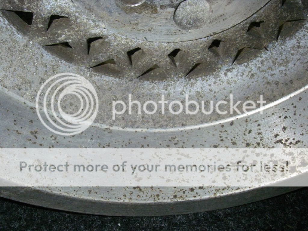

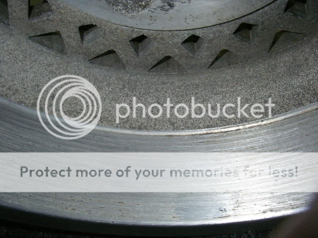

Here's something that's brought some success for me. I've been working at cleaning the corrosion on these old Appliance aluminum wheels with 3M sponge sanding blocks for the larger areas and folded sheets of sandpaper for the "nooks $ crannies".
Before:
After:
