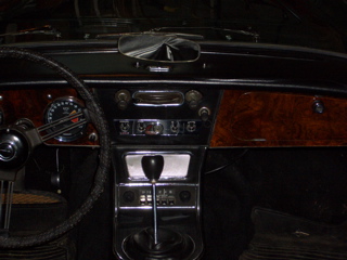

Anthony,
I've attached a photo showing the location of the cigar lighter in my BJ8. It is just up and to the right of the headlight switch. I believe this to be an original dealer-installed item as the interior of my car has never been redone as far as I know.
Wana
thanks,keoke,i also coulnt find a call out for a bracket, /ubbthreads/images/graemlins/crazyeyes.gifthanks james wilson,from the photo of your cool looking car im not able to disearn what side your steering wheel is on [you being from glasgo]so when you say 'center lower right?just kidding, /ubbthreads/images/graemlins/devilgrin.gifand wana thanks nice lookin dash!i hope ya didnt armoral it just fa me! /ubbthreads/images/graemlins/blush.gif p.s theres a healey for sale on ebay,got white walls!i godda stop smokin anyway /ubbthreads/images/graemlins/nonono.gif
Looking at the picture Wana supplied, the one I have is positioned down two inches more-or-less, consider a clock face- theirs is at 1 o'clock mine would be at 5 o'clock relative to the switch... in the center panel, at the lower right. I hope that's clear now.

My 65 BJ8 has it exactly as Wana's photo. According to what I have been told, mine was delivered new in the UK as a left hand drive and then later flown to the US. If it was installed by the dealer, he was in the UK. While on this subject, let me ask about the UK license plate that came with my car. It doesn't have the border around it like the one that Moss sells. It is just plain letters/numbers on black background and made from Aluminum. DGP-537C Is this authentic ? Or did a PO install an aftermarket plate? Is MOSS's plate not correct as issued in the UK in 1965 because of the border ?

My Cigar lighter is through the center metal plate of the dashboard, ( covered with vinyl) in the same location as in Wana's photo. This is not wood but the
vinyl covered metal piece that makes up the center of the dashboard. The Wooden pieces screw onto either end of this center metal piece.
I suspect that in my and Wana's BJ8, these Cigar lighters were installed at the factory. It is unlikely someone at the dealership drilled a 3/4-1' hole through the vinyl and metal dashboard section.
