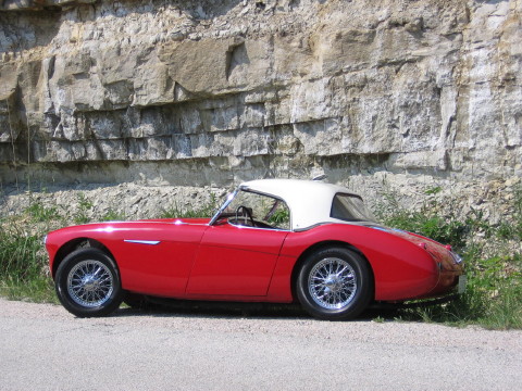

Hmm, why go with chrome? If you're trying to retain the classic look, painted 48 looks great. In fact, if you like the chrome wheels why not go with the 48 spoke chrome wheels. Here's a picture of a fellow enthusiast with chrome 48 spoke wheels on a BN2. Just click on attachment above.

Johnny, Boy, I sure like the look of the 48 spoke in chrome... Thanks alot, now I have become undecided again!!!
