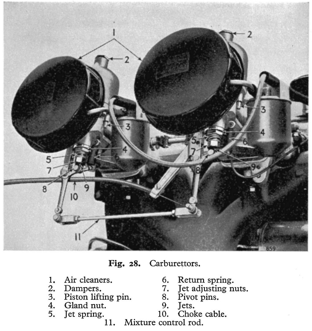

Normally, the first part of the choke travel only moves the fast idle cam. I'm guessing you weren't actually getting the jets pulled down at all (which does make it difficult or even impossible to start). Difficult choke operation is another common complaint. I've found several causes:
1) The outside of the carb jets should be polished quite smooth. Originals were supplied very smooth, but replacements are frequently much rougher and need to be polished before installation. Just plain old white toothpaste and your fingers will do for polishing them (but be sure to clean all the toothpaste out before reinstalling).
2) The cork seals that the jet rides in don't last very long and tend to start weeping fuel after just a few years of service. There is a spring inside the jet assembly that puts force on the seals; and some people will try to stretch that spring to stop the leak. But the excess force makes the jet much more difficult to move (and won't stop the leak for long). The cure for this is to replace the springs (which are available separately for just a few dollars). (You can also change the cork for nitrile rubber aka Buna-N O-rings which last much longer.)
3) Both of the above problems can lead to the jets not returning fully when the choke knob is released. Again, some try to 'fix' this problem by trimming turns out of the jet return spring (the big extension spring on the side), which of course makes choke operation that much harder. Again, correct springs are available separately (but not included in the rebuild kits).
4) The factory arrangement of the link between the carbs seems counter-intuitive, so it is often installed wrong. Believe it or not, the factory method works better.
FIG28CARBURETTORSLINKAGE.jpg~original
Randall What do you think of Bob Shaller's set up of the front end of 11. mixture control rod in his More BS about TR's booklet? I've had mine set up like that for years.Think it makes any difference?
Thanks Randall, have the jet "kit", plus Buna-N O-rings on order. The choke still has a pronounced "hard spot" on the forward carb, which the cable can't quite overcome. (factory arrangement still in use per picture).

I have a question on the two brass choke levers that are each attached together by the control rod. There is a pivot pin that attaches each lever to the carb. On both of my brass levers the hole that the pivot pin goes in is not round and is quite sloppy. The hole is more of an slotted egg shape. It takes a lot of movement of the choke cable to over come this before the choke starts to pull the down.
I not sure if this egg shape is due to ware of if is in fact made that way from the factory. I'm tempted to braze the hole up and drill it round to take out the sloppy fit to the pivot pin. Any advice on this would be appreciated.
The hole is supposed to be round, but it is also supposed to be quite a bit bigger than the pin. The movement "taking up the slop" also moves the fast idle cam, so there is a range of knob positions where only the fast idle cam is activated. Useful for when the engine is only partly warmed up, doesn't need any extra fuel but does need some extra air to idle smoothly.
IMO, unless the hole is worn completely through, it doesn't need to be repaired. Yeah, you lose a bit of jet motion due to the wear, but the jets will come down a lot farther than needed anyway. Mine are somewhat worn, but the linkage comes up tight against the jets with only about 1" movement at the knob, and I rarely use more than 1/4" beyond that. Maybe 1/2" if temps are below freezing (back when I lived where it got cold).
Won't hurt to replace the pin, though. If the lever is that badly worn, the pin can't be far behind.
PS another common cause of hard starting after the car hasn't been driven for a day or two is leakage at the float bowl mounts. They will often leak just enough to drain the bowl eventually, but not enough to drip. To check, rub your finger across the bolt (or nut on some carbs) underneath that retains the bowl, and smell your finger. If it smells of fuel, you've got a leak.
One (or both) of mine seems to have just started leaking again in the past few days. This morning it started on two cylinders and ran that way for several seconds before the other bowl filled up. Guess I'd better change those darn seals again! Only good part is, it can be done without removing the carbs.
Don't braze up the hole and drill it. I tried that and it made matters worse. That hole is supposed to be a slotted egg shape for the set up to work properly. Try the other suggested linkage fixes instead.
I've got several old TR3 SU carburetor sets and the hole size on those levers is different on all of them and quite oval one the set on my car (probably from too much tension on the cable). I thought about changing to less worn levers to see if it helps with my problem but as Randall said, it doesn't seem to matter much and I know the jet is not right so will fix that first.

I have the stock choke with the locking mechanism and it's set up (as Randal pointed out) so that the first stop is only setting the fast idle cam on the carb. I struggled for years with the excessive resistance at anything further out than the first stop. At one point I completely disconnected the choke cable at the carbs. I then hand tested each choke and found little or no resistance on either. I had set up that connecting rod (11) as the factory showed and as Schaller showed. I finally eliminated the rod to the rear carb & VIOLA! Problem solved! I can pull the front carb choke ALL the way (4 stops) with zero resistance. In sunny So. California it starts in 2-3 cranks and in 32Âş F (Prescott AZ in the winter) 3-4 cranks. Neither the 3 nor I will ever see sub-zero temps so I don't know about that.
FRank
Some wear may be incvolved but 'sloppy fit' is as orginal.
The stock TR3 choke cable should have a locking mechanism. There is a brass piece inside that wears out, but a replacement can be made with a file or Dremel & some determination...
If that is the piece I am thinking of - small, shaped like a thin capital D - it can fall out if the cable is completely withdrawn from the housing. Its loss may go unnoticed if you do not know about it and from then on there will be no locking the position.
My new brass levers have the same sloppy holes. IIRC I read somewhere the sloppy hole is to allow the jet to return to its off position or so the first movement sets the fast idle. Remember it is meant to be like that but forgot the Why.
As the choke is pulled out the lever moves a bit then the hook above the hole engages in the pin that is part if the link mechanism.
