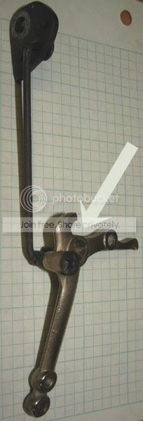

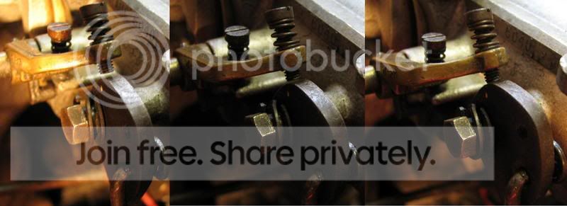

I've taken some photos, as Randall suggested. Here's the general setup:

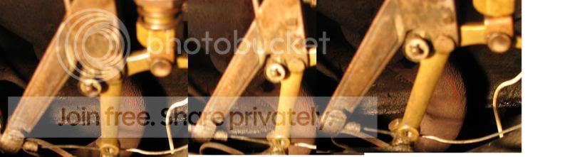

Left to right, is the effect of the choke cable at rest, one notch out and then two notches out:
Adrian
TS58324
Hmm, hard to be certain without mine handy to compare with; but I think the problem is that the joint I mentioned before is too tight. The hole through the arm at that point is some 3/8" in diameter, while the pin is only maybe 3/16". The idea is that, at rest, the spring pulls the lever down until the pin hits the top of the hole. Then as you start to pull the cable, the lever pivots against the jet, until the pin hits the bottom of the hole. The net effect is to move the rod to the fast idle cam by roughly 3/16", before any downward force is applied to the jet.
On my TR3, the movement at the pin is very obvious, while I don't see any movement at all in your photos. Perhaps someone has tried to 'improve' that joint; or the bracket is just bent until it's tight against the lever.

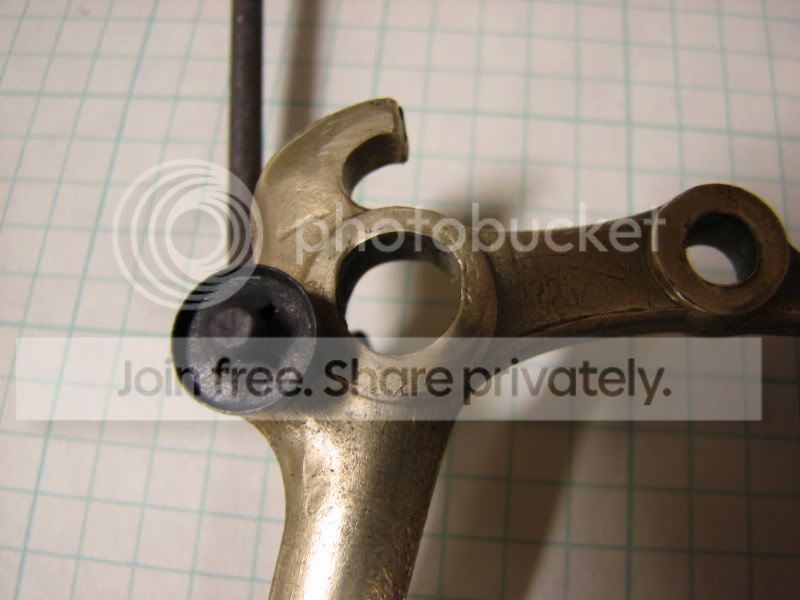

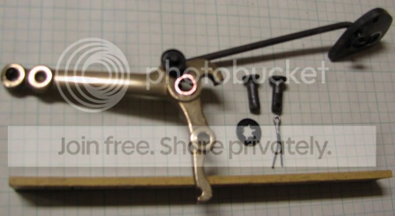

OK, maybe this is where the problem lies:
Here's a close-up:
See how the hole is no longer round. Is that why the link is not being pushed up to turn the fast idle cam?
Adrian
TS 58325
I wouldn't think so. Just the usual wear, to my eye. And if anything, I think it should increase the movement of the fast idle pushrod.

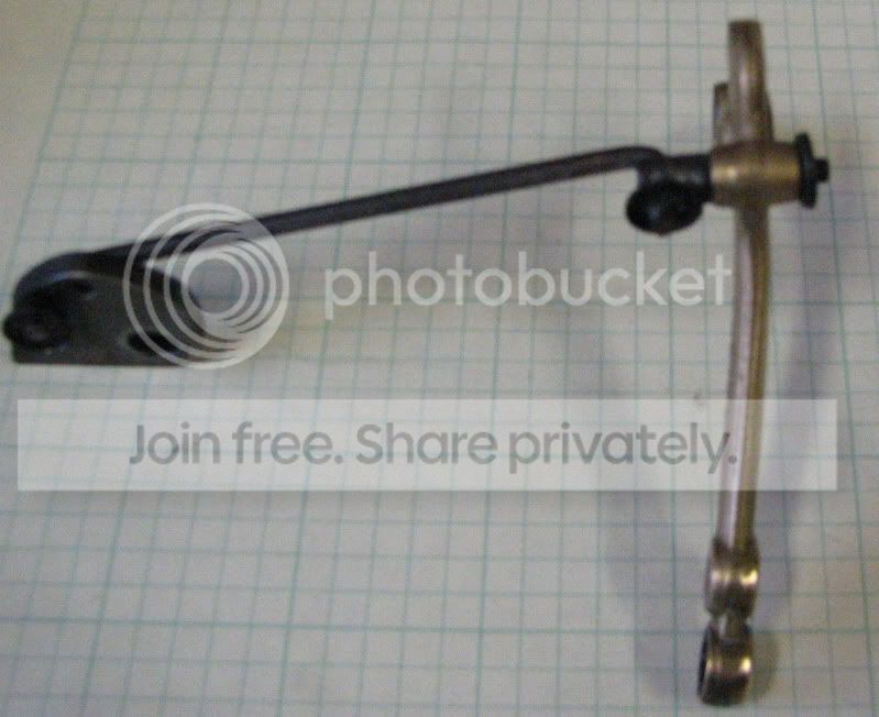

Sad, I'd already fabricated something:
By some miracle, 1/4" pipe fitted in the hole and also gave a fair amount of requisite slop. I was just messing around - that jet lever is available from Moss Motors, fairly inexpensive.
I'm curious as to why some of those pins are held by star washers and others by cotter pins. Why is that?

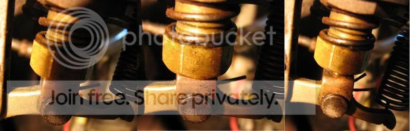

Well, maybe I was just mistaken about how obvious the movement is. Here's before n after on mine:
Randall,
Thanks for taking the photos. Yeah, I can see that it does move up some.
Looking at the Moss Motors diagram, I'm missing what might be an important washer (between fast idle cam and carb) That might be why there is not much movement. I'm thinking it is special at $2.
I've gone ahead and ordered it, along with a jet lever. That one I have is a bit bent - maybe that's the problem. I'll stick it in a vice and try to straighten it AFTER I have the replacement from Moss in my hands. Brass should bend OK, huh?

OK,
The good news is that the jet lever can easily be straightened in the vice without resorting to heat. This, and the new washer, (between cam and carb) however, did not help any.

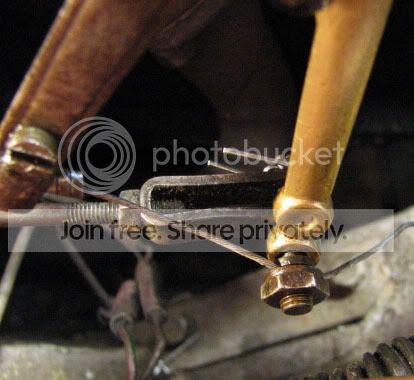

After fiddling around for a stupid amount of time on this I did get quite an improvement by switching the position of the choke cable where it attaches to the jet link, as shown below:
Both Haynes and Moss Motors catalog show the attachment point on the <span style="font-weight: bold">other </span>side, towards the engine.
Switching the position to as shown, I got a movement of 11 thou, as measured with a dial indicator on the throttle stop screw (hey, I said it was getting stupid)
So now the cam moves when pulling out the choke cable to the first notch and then, on pulling to the second notch, the jet lowers by about 1/4". All good stuff I thought.

Believe it or not, I was going to mention the cable being connected wrong, and somehow didn't do it.
In your photos, I see a lot of 'daylight' under the fast idle adjustment; is there some reason you can't turn it down a few turns? Never tried to measure it that closely, but IMO the motion should be a lot more than .011" before the jets start to move. With the engine warm, you should be able to pull the idle up to between 1500 and 2000 rpm.
And on cold mornings, I do find it necessary to keep the choke partially out for the first 10 minutes or so, for smooth operation.
Have you checked that the carb pistons move totally freely without the dampers installed? And that even with the dampers, if you lift the pistons (engine not running) and release them, you can hear the 'click' as they land? The slightest binding or tight spot can cause all sorts of strange problems.

That's interesting - the Haynes manual (and VB) shows the cable connection on the engine side for the H6 carb (called a H5 in Haynes). Moss shows it on the fender side. The cable was pointing more to the fender side so I relocated it there and it seems to work much better.
Haynes also says there should be a 1/16" gap between the adjustment screw and the cam - hence the big gap you saw.
It seems pulling the cable merely raises the cam - the cam does not rotate, as I would imagine it should. I took out the bolt securing the cam and polished the unthreaded portion with emery paper using the drill press. Put it back in and liberally oiled it up but no joy.
Anyways, the choke action is much better than before.
