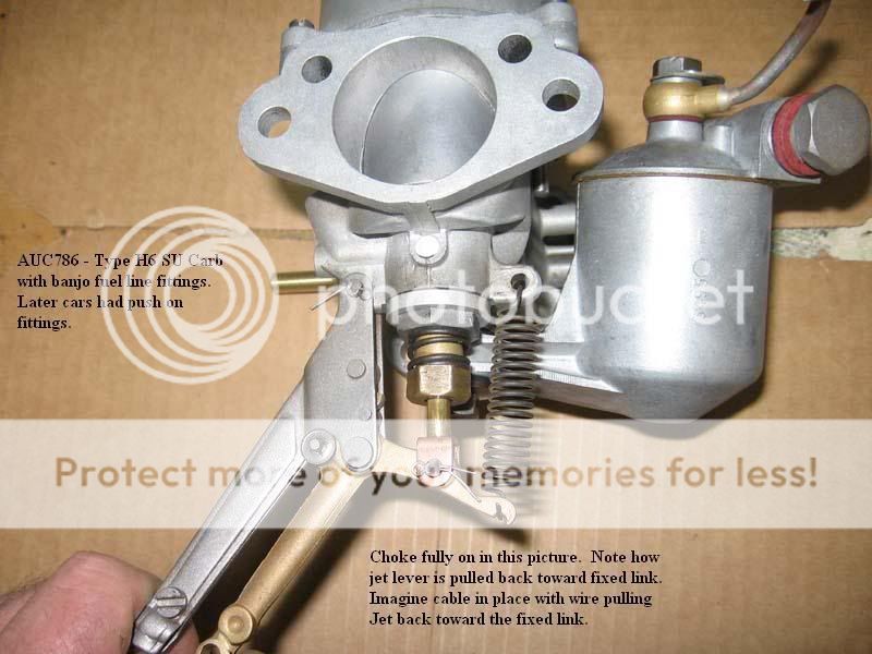

Does anyone have a picture (not a pdf) of the H6 pair mounted on the TR3A engine, *showing detail of the choke and cable attachment*?

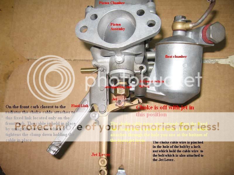

Best I can do.
Good job Harry!

Hey Harry,
Those are my carbs in the first two pictures... /bcforum/images/%%GRAEMLIN_URL%%/cool.gif
Excellent! A zillion thanks!

Yes they are and I should have mentioned that! Thanks, it was a lot warmer (not to mention cleaner) working with your carbs as mine are in the 9 degree F garage where I would have had to take off the air filters. I told you they would come in handy as these carb questions seem to come up a lot.
I like the way you annotated everything. How is that done?? Can I do that in a basic Photoshop program??
Art,
You can do it in Photo shop which is a better program but I used basic old "Paint" which is a standard windows program listed under accessories. Open your photo in paint, click on the big capital A in the tool bar on the left, choose how you want it to appear IE picture intact or in a colored block of its own. I click on the lower box which leaves the photo intact and all you see is the letters. Then you create a box where you want the letters to appear on the photo that's also big enough to hold your font size, and type away. The hard part is figuring out what color will show up best on the background after you save and post it.
Great pics Harry, however it appears the connection is not made correctly. On the front carb the jet lever goes on the motor(inside)side of the connecting rod fork. If placed inside the fork you hamper the ability of the jet to properly return.
Ed,
Brrrrr, you made me go in that cold garage. The choke cable pin which the cable attaches to is in backwards as well. Wire hooks up to the engine side. Thanks for pointing that out. To all, sorry for the confusion.
