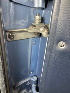

UPDATE - Today I repaired the passenger check strap. After thinking about the comment red57 made about Healeys using plenty of fine thread fasteners so the engineers decision to use coarse threads for this application was on purpose. I chose to stay with the original design, with a twist. I purchased a 5/16" -18 x 1-1/2" grade 8 left hand bolt and matching Grade 8 LH nuts from McMaster-Carr. I spot welded 3 nuts together to give me the equivalent of a coupler nut, figuring the more threads in contact with the bolt, the less likely for it to strip. I had done this 20 years ago with the driver side door and it is still working perfectly. For the driver door I was able to buy a right hand thread coupler nut so that was more straightforward. I couldn't find a left hand thread coupler nut in 5/16" size so I built my own. The finished product works well even with the added weight of the side curtains. Here are some photos. If anyone needs any Grade 8 5/16"-18 left hand nuts, let me know. I had to buy 25 and I think this is the last time I will need to do this repair........

Good work!
One thing that I did was to make new "wrenches" out of 1/8" steel. I think my check straps may have been reproductions because the "wrenches" kept bending and opening up.
