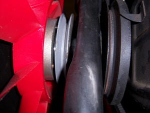

I'm read to try moving the engine and trans back, but it seems like that will put the cross brace to close to the front pulley. I have attached a picture. Is there more than one fan extension available?
BTW, the fan in the picture is from TR6Bill. Thanks Bill.

David, what am I missing here. What in the world is an extra fan pulley doing on your fan extension?? There should be no pulley on the front of your fan extension, just a steel donut called a "fan extension adaptor". Tell me that wasn't on there all along. I am confused. Look at the Moss catalog or Rimmer Bros. catalog online and see the blow-ups. There are not pulleys on the front. What gives? Also, your cross brace seems or appears in the photo to be compressed in the middle. Was that some weird addition? Did or does your car have air conditioning, perchance?
This car probably did have a/c. It came with a box of a/c parts (compressor, coils, etc). I looked in Moss, VB, and the TRF blue book. None of them show the fan extension I have. I may try to switch it out if I can find a regular fan extension. With that done, I could see how moving the engine back would make a difference. Does anyone need any a/c parts???
Yes, that is a fan extension for an AC equipped car. If no one offers up an old extension for you, you could always get one of those shiny 'billet' extension on Ebay or eliminate the fan and the extension and go to a 16" electric puller fan. Just some thoughts. /bcforum/images/%%GRAEMLIN_URL%%/wink.gif

What is width of your fan belt (3/8 or 1/2)? The Gm alternators use a 3/8 pulley,so if your thinking of changing the fan extension, you could change to a harmonic balancer with a 3/8 pulley and use a 3/8" belt.That would give you 1/8" more clearance between the cross brace and the pulley. Im assuming you have the 1/2" pulley at present.
Two things would still exist. The pulley on the water pump and you would still have to take the cross brace out to change the harmonic balancer. I'm just thinking out loud.
Just a thought. Did I add more confusion.:-)
Joe
Hi Joe. The fan belt is 1/2". I had a 1/2" pulley put on the GM alternator, so I think I'm okay there.
