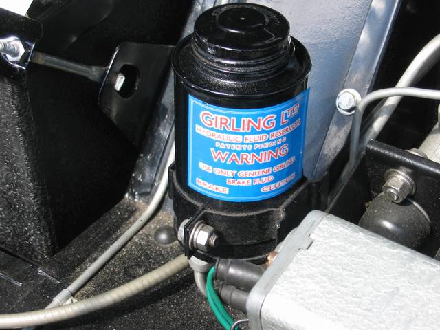

I have used silicone brake fluid for the clutch and the brakes in my TR3A since 1990. There is only one reservoir that supplies both. I only added fluid since I filled it in 1988. Since I got the car on the road again in 1990, I have driven 98,000 miles. With silicone fluid, I don't have to worry about any paint peeling when it leaks and it won't absorb humidity, so I don't need to drain and change it. The lubricating properties of silicone means that the cylinders will never rust or become jammed.
My fluid turned black. I don't worry about that. When I had some work to do, I drained out some and let it sit. After about a month in a jam jar, the sediment had collected at the bottom and the brake fluid was purple again. I l;ater re-used this purple fluid. I don't know why it turns black. It might be carbon or something from the black rubber seals in the master cylinder ? Some TR6 owners have reported that their fluid turns clear. Some suggest it's because the brake reservoir on the TR6 is translucent plastic and the light gets in and changes the fluid from purple to clear. My reservoir in a closed can, except for a tiny breater hole in the top of the fill cap.
