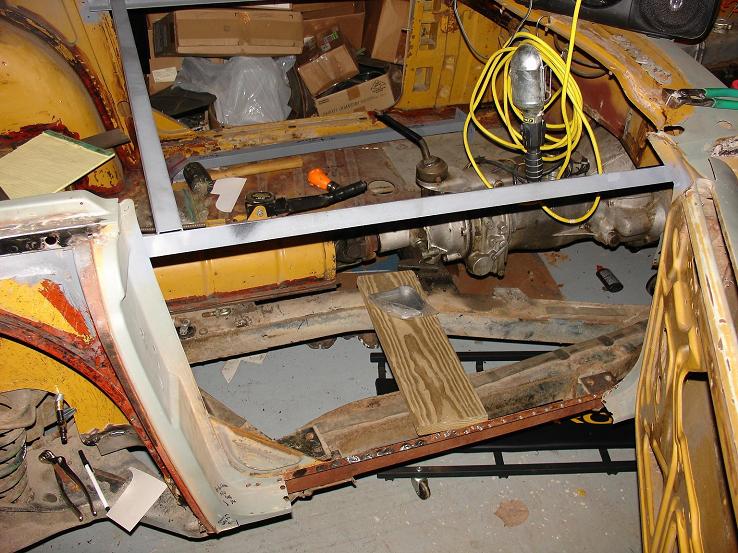

The only point I will differ with Alan on is the necessity to weld in the braces. As you can see from the above attachment, I bolted in the door braces, and the year and a half that I've been working on the car, I have yet to see anything move. Also, with a proper brace, it shouldn't matter if you remove the trans and/or engine. Having that tranny out of there will make the job much easier. I lift the whole body off the car by the center brace with an engine hoist which is capable of rolling outside if I need to do work underneath or on the chassis.

For those of you that have done this before, I need a little insight. How do you get a full floorboard in while the car is still on the frame? The attachment shows the car in its present state. I tried to get the floorboard in but it looks like I'm going to have to unbolt the body in the engine bay and atop the rear end. Do I need to unbolt or just cram it in? Also, when should I weld in the sill mounting brackets? I imagine that the sill brackets would go in after the floor is in, right?

I haven't done this job on a TR6, but I have on my TR3, and there is some similarity. Because the floor actually lays on the frame in some places, I don't think that you can wiggle the floor in without lifting the body some. I had the body on my TR3 up a few inches from the frame when I slid it into position.
The sill mounting bracket problem I will let someone else answer, as I'm not familar with that. However, from looking at Moss online, it appears that they should go in first, as the floor lays on top. It might be easier to weld those on first, as you have better access then having to go underneath after the floor is in. Perhaps you can lay the floor in, use a few sheet metal screw to hold it in postion. Then you can position the sill plates, tack them in, remove the floor, and finish welding the brackets in.
