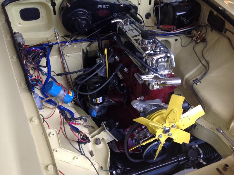

Nothing particularly difficult about changing the hose and bleeding is what you would expect. I added a remote bleeder when I changed mine out and it really makes a difference for us old folks. You can see it next to the heater blower...cheap and easy!
Rut
