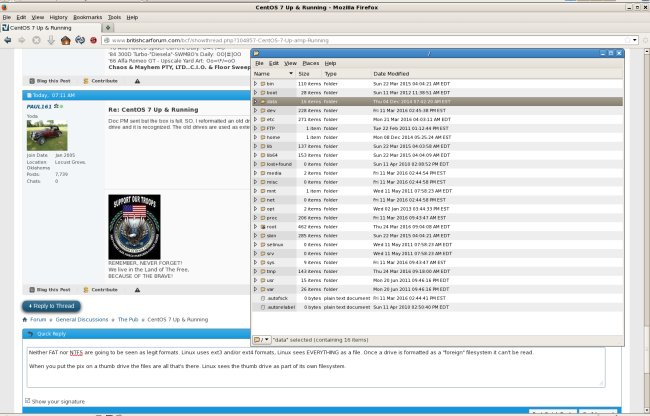

Doc PM sent but the box is full, SO, I reformatted an old drive from NTFS into a FAT drive and it is not recognized either. Is there a way I can make these old drives I have look like a thumb drive? I tried a thumb drive and it is recognized. The old drives are used as external drives just for storage. PJ
Neither FAT nor NTFS are going to be seen as legit formats. Linux uses ext3 and/or ext4 formats, Linux sees EVERYTHING as a file. Once a drive is formatted as a "foreign" filesystem it can't be read. When you put the pix on a thumb drive the files are (or should be) all that's there. Linux sees the thumb drive as part of its own filesystem.
BTW: Here's a layout I use to transfer "stuff" so as to locate it easily on Linux. I create a "data" directory in the root and set up sub-directories to file the different things for easy retrieval.

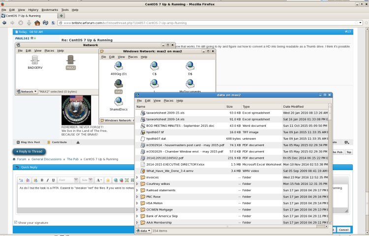

As do I but the task is a PITA. Easiest to "sneaker 'net" the files. If you were to network the machines using SAMBA, it makes file transfer between machines a piece of cake. Your time could be better spent getting SAMBA up and running.
The screenshot here is with a couple of the network boxes now running, "MAX" is a WinXP machine and ALL the files on it are seen and can be ferreted across the 'net:
BTW: BADGERV is this Linux box, a few more machines are not booted up now, but one is Win7 with two others running Linux. All play well with one another on the LAN. You could plug your external drive into a Win machine, "share" it and copy the entire contents to the CEntOS machine.

Curious. You must have SAMBA running then. That's the only interface I know of to allow the two to inter-operate.
On boot, if you tap the "esc" key when the CEntOS loading splash screen comes up, you will see a list of what's loading. SAMBA loads as: "SMB" and "NMB".
EDIT: Just dawns on me... Fedora! Most likely SAMBA was part of the install with no need of opt-in from the installer. A "convenience" for the system to be inserted into a Windows environ. CEntOS is a bit more of a "beat it into submission" version. Much less 'automagic' than Fedora.
