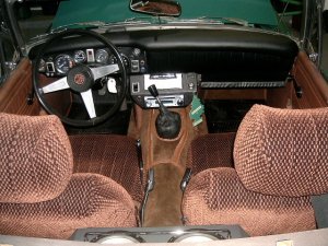

Installed the center consol in my 74 and the darn thing does not fit properly because the new radio is a little longer than stock. My other issue is that the corner of this thing pokes me on my right knee! I would like to remove it so I am looking for alternatives. I really want to keep the radio but I don't need the lighter, flashers etc. I know that the members here are very clever so I turn to you.
do you have pictures?
You get used to the knee bump, but when I redo my midget I'm going to eliminate the stock console and fit a simple box console under the dash.
Currently, I moved my stock console out (for stereo clearance) by fitting a 3/8" piece of plywood behind the center panel.
This is current. The lower left corner jabs me in the knee. Okay for short rides, very uncomfortable for longer rides.

Yes! Yes! A simple box consol. Is there an off the shelf that will work? The radio must stay low on the hump or else I will hit my knuckles when I use 1st and 3rd.
You can take a 3/4" thick piece of plastic, preferably black, and make a shim for the radio. Inside rectangle the size of the radio and outside 1/2" bigger on all sides. Drill and tap holes in the back to secure it to the console from "inside" the console. The biggest problem is that you need to be in 2nd or 4th to get a CD out. As for banging your knuckles, you can always cut down the shifter and inch or so.

I had to reform the original for some radio clearance issues due to my V6 conversion. I used 20 gauge sheet and set the radio in at about a 40 degree angle. The console still hits my leg a bit, but it's not a problem for me even on rather long trips of several hundered miles, guess I'm used to it now. The shape of the new console is a bit more leg friendly than the old one. There's a pretty good shot of my console in the British V8 Newsletter coverage. https://www.britishv8.org/MG/BillYoung.htm Sorry it's all in black so it doesn't show up too well.
