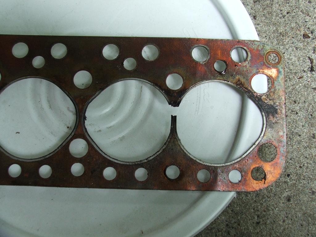

The gasket failure between the cylinders is bad news, of course, but the burned area on the far right is a concern too. Be sure to check the head flatness.
I can't see why the car would run OK for the first 20 minutes or so, as you described, with a blown head gasket. Maybe have to chalk it up to the vagaries of these little cars' behavior.
Glad you found it, though.
