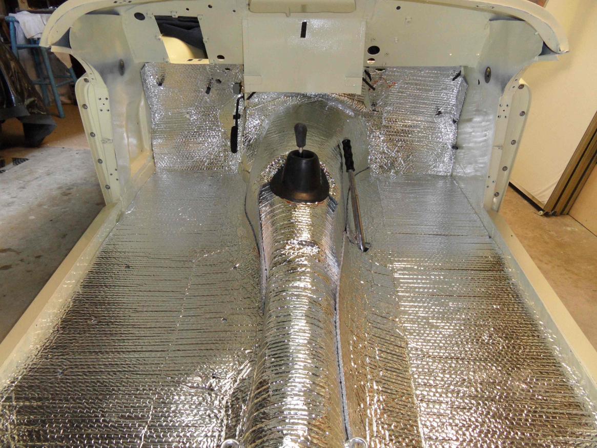

I got some insulation stuff from a local hardware store that has foil on both sides and a sort of bubble wrap in the middle. It works well as sound/heat 'proofing'. If (When) the car gets real wet, I have to remove the seats (and carpeting) to remove the stuff, but nothing is attaching the three sections to the floor but habit/fit.
