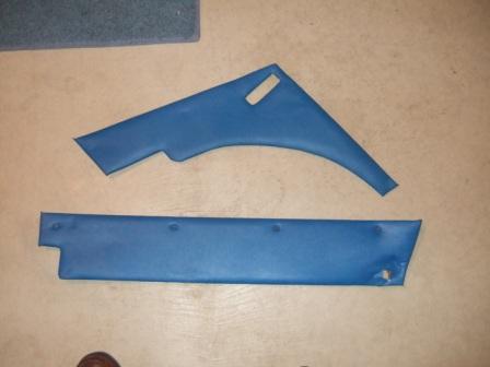

On my 65 those areas are covered withvinyl pieces that are attached to masonite board of some sort.
Mark

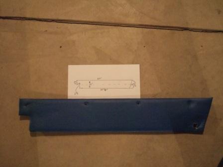

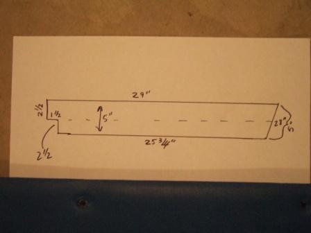

Mike,
Here are those pieces, let me know if you would like measurements.
Mark

Mark:
I hate to put you to two much trouble but if you have the measurements that would be great.

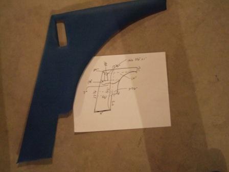

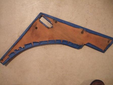

Mike,
Here are patterns for both pieces, the upright piece over the wheel well is held in place with a clip Moss#317-070 page 58 #56. They fit in the 5 round holes you see in the last picture.
Mark
