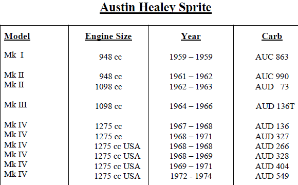

I'm running AUD136's on my 1275 which work fine for me. Had not heard of the AUD73's but found chart below that they were on early 1098cc sprites.

Thanks for the chart. I knew the AUD73s were originally fitted to the 1098cc engines. They're in much better shape, though, than the AUD136s I have, which are in need of a major rebuild/restoraion. Based on my engine number, it seems like the later model carburetors might be better suited; just can't determine exactly where the 12CD engine fits into the scheme.

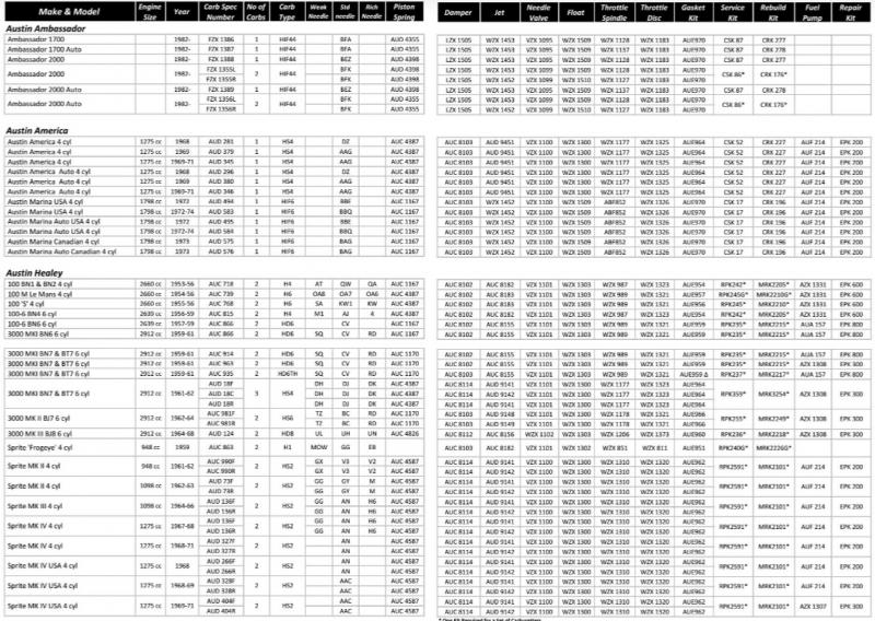

Here are the details of the carbs as well for all Austin Healey's. Looks like the main difference is the needle selection. Cheers.
