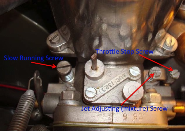

Please review my picture indicating the adjustment screws and let me know if accurate.
Looking at the Haynes Manual (Pg 77), Fig 3.11 and Fig 3.12 contradict each other in terms of Jet Adjusting & Throttle Stop Screws.
Please let me know if my picture is correct.

It seems ok except what you call a "Jet adjusting mixture screw" is only the screw that attaches the adjustment screw to its shaft.
