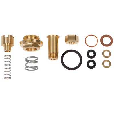

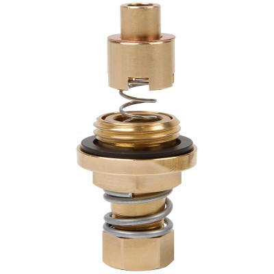

Anyone have experience with the new Superdry Jet Bearing assembly offered by Moss?
Kinda pricey, but might be worth it to avoid a lot of hassle and trial and error. 370-396_2.jpg370-396_1.jpg
