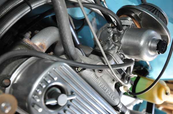

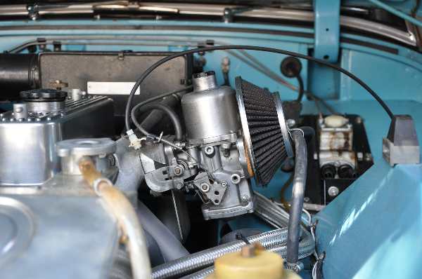

+1 easy conversion - use the rear carb from an MGB as the bolt pattern matches.
Kim, if you ever want to try the single SU carb let me know, I've got plenty of used carbs.
Billm said:
A single HS4 will fit with just a very little work and will probably run better than a Webber (and give better milage too) on a 1500.
BillM
+2
I have an HS4 conversion on my 1500 Spitfire. It is much easier to deal with than the Stromberg. Someday... I'll fit the dual SUs I have in the attic. For now the single carb is more than enough for my needs.
