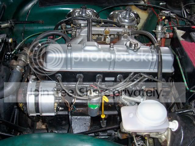

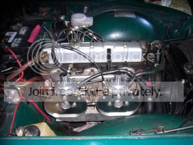

But whatever you do do not cap or seal the nipples like the one I show here colored red...Never.
Poolboy --
Thanks for the photos. What year is your car? Are you running any vacuum between the carb and the distributor? I will come back with some better details.
Thanks.
No vacuum retard on the 73 in that picture. The retard is not necessary. It was really just one method TR used to obtain US emission compliance back in the 70's.
I had a 74 for a few years and as you may know, it had the most complex emission vacuum plumbing of all the years.
On that car some of it was connected properly and some of it not at all when I bought the car.
Pretty much on my own, I began to rearrange things and observe the effect.
Although there is more I could have eliminated such as the Tkrottle Bypass Valve, the distributor's vacuum retard and the Thermostatic Vacuum Switch, this is where I stopped. Knowing then what I know now I would have.
