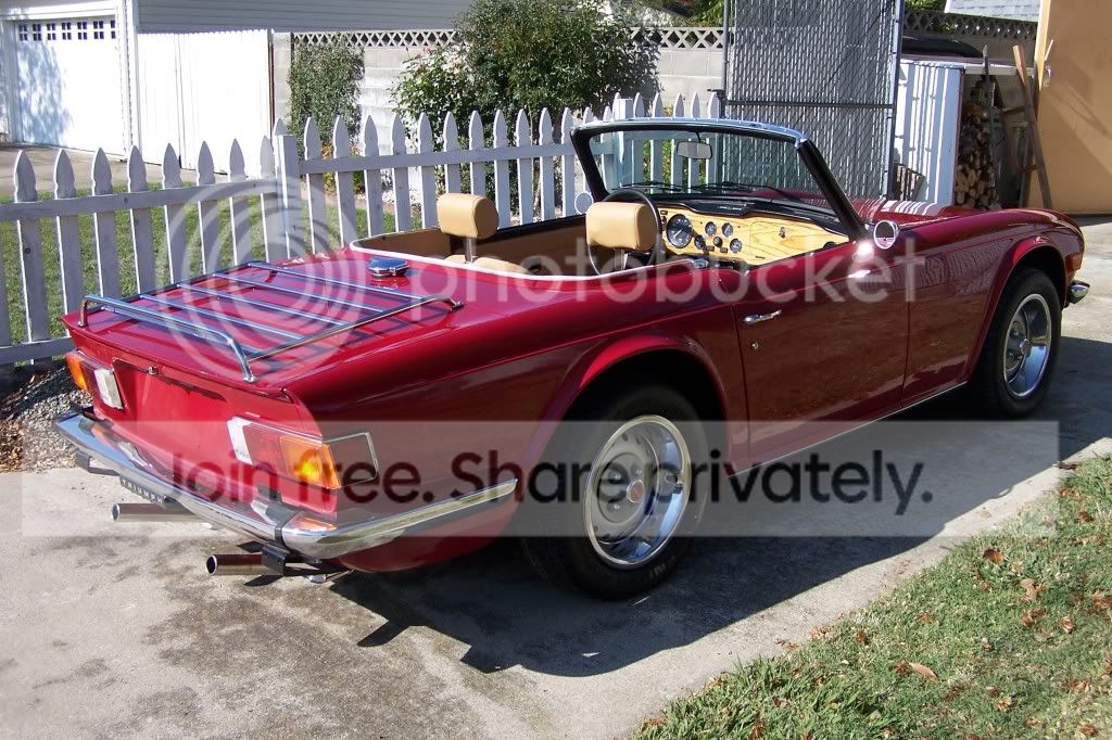

I know it may not be what you want to do, but I trashed (ok I removed them, but didn't throw them away) the original emission control ZS CD2 carbs on my TR250, got a used set of TR4A strombergs on Ebay, which are much simpler, you basically have two adustments, Idle speed and mixture, rebuilt them with new shafts and such and for less than $200 all in the car has never run better.
They look OK too.
