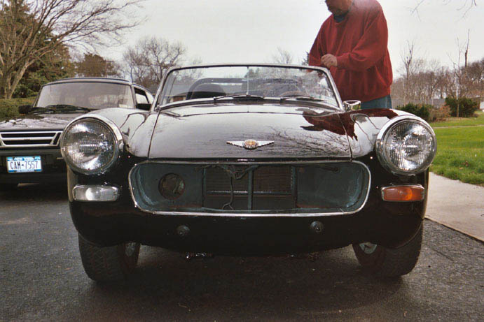

Is that your red Sprite in the picture? If so, is it a racer?
nope thats not my sprite. I would love to race mine but finacially I don't think I could support it yet. I'm in colleage right now so money is tight. Heres a pic about a week after we got it to about "road worthy" condition.
