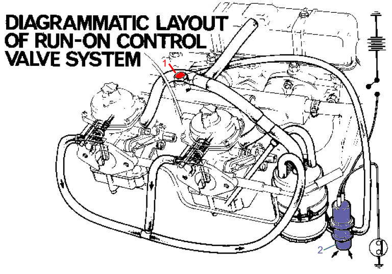

<div class="ubbcode-block"><div class="ubbcode-header">Quote:] is the Anti-run-on valve on the canister? [/QUOTE]
Hanging down underneath the carbon canister, if it is still there.

<div class="ubbcode-block"><div class="ubbcode-header">Quote:]Also, i'm kinda vague on the intake Banjo fitting. just took a look with the flashlite and could not locate such a thing. [/QUOTE]
