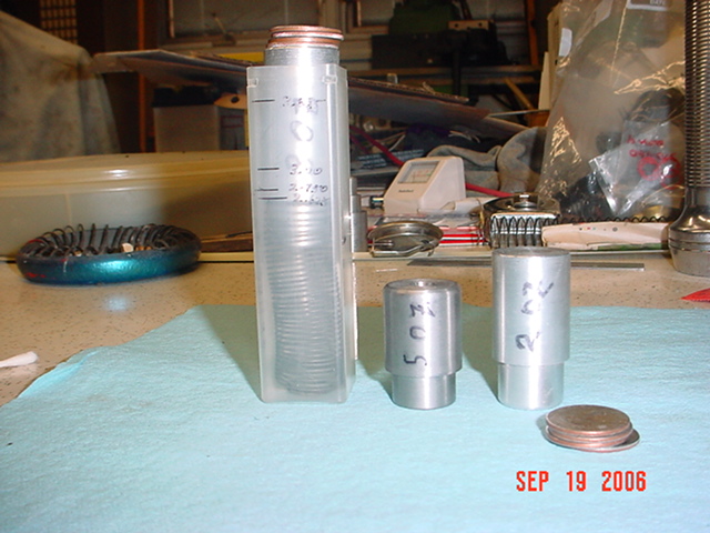

See the attached pic.
A crude but effective spring checker.
A transparent box just larger than the spring OD.
Calibrated weights to compress the spring. Someone with an accurate scale can calibrate the test weights or you can just stack quarters to suit.
The pic shows a red spring that is somewhat under it's original rating. ie, 2 5/8" at 3.8 oz. Where it should be 2 5/8" at 4.5 oz.
The absolute spring weight is not so important as having the springs matched. The tension can be increased by slightly stretching the low one until they match.
