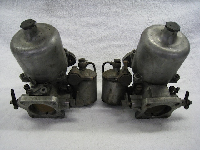

Take your time doing the carbs the first time around and do not mix parts between the the carbs and use a digital camera to help and you should get through this job with no problems.
Once you have them on your bench, you can clean all the dirt, oil and junk out of the areas you can't normally get to.
Then theirs guys like me who seem to have too much time on my hands.
There, they're clean now...lol

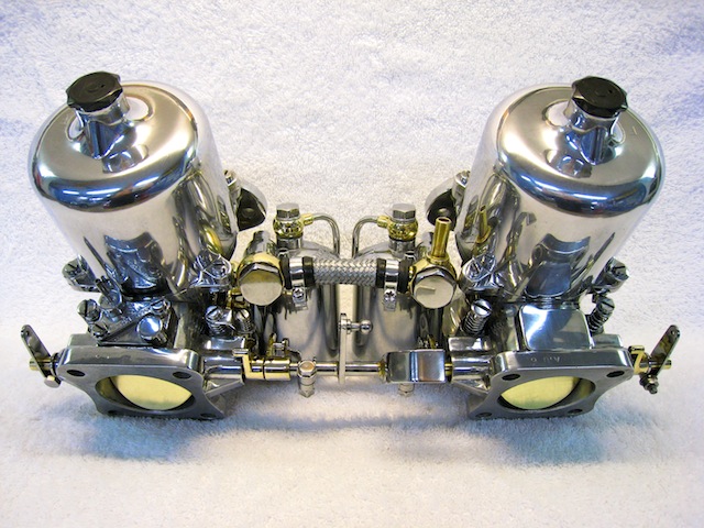

How about showing us the details...what you used and the process, etc.
Sitting at my bench for a couple weeks doing some wet sanding, and using my dremel and hand drill to polish. Used different grades of polishing rouge. Replaced all the small pieces that I could with stainless (polished them) and chromed some of the larger pieces that are unique to the carbs. All aluminum parts were polished. Good times!
They look great. Did you polish the butterfly's too?(can't tell from the angle they're sitting at). LOL
