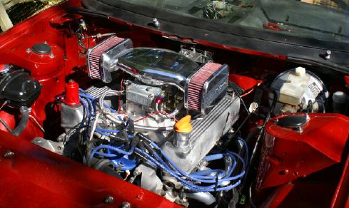

Mickey, everytime I see one of your posts I want to blow up that photo in your avatar for a better look. It looks so shiny and nice! Do you have a larger pic?
Thanks, John!
Lemme see...
