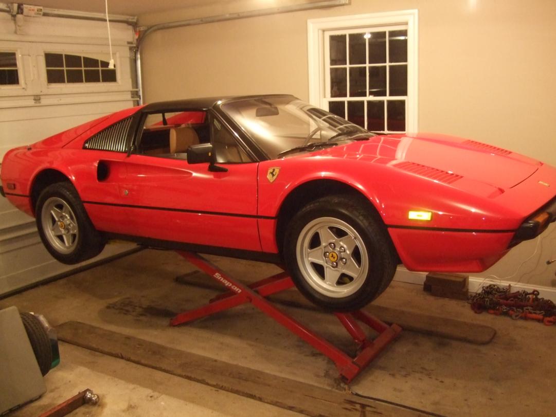

I could have bought a two or four post lift, but decided on a mid-rise lift for several reasons. First of all it doesn't take up much space and is moveable. It doesn't take any special wiring, no drilling into the floor, and gives clear access to the car. It is low enough to park right over it, but lifts the car high enough for brake and suspension work, engine servicing, greasing front end, etc. It is also great for bodywork, waxing, vacuuming, interior work, etc. as you can lift the car right up to where you need. All these considerations were important to me in my particular situation.
The only drawback for me is that I can't work on the center of the car underneath. For me, that wasn't a big deal as not alot happens in the middle of the car, other than changing speedo cables, transmission oil draining, maybe clutch slave cylinder work. I can live without that capability for the other pluses. This negative doesn't even apply to a mid engine or rear engine car (think Porsche 911), and I've had a few of those over the years.
With the Healey, it doesn't interfere with the exhaust system as the lift is narrow enough to allow clearance. The frame of the Healey is almost exactly the same width as the frame of the lift, so it is very easy to set up. Below is a link to a picture of my lift with my other sports car. I don't have one with the Healey (the Healey doesn't need to spend much time on the lift!).

Like the car also, but would like to know how do you operate it, and how much does it cost?
Hi Johnny,
I'm not sure if you were asking about my scissors lift or not, but assuming you were: I bought mine about 10 years ago from the local SnapOn tool dealer. I paid right around $2,000 then. If anything, the prices have probably come down, and I'm sure there are many different suppliers.
The lift is heavy (maybe 800 pounds), but just lays flat on the floor, requiring no mounting or anything. It can be moved, slid around, whatever. There is a separate power unit which plugs into a regular 110v outlet. This pumps hydraulic fluid to raise the lift. There is a manual safety that holds the lift in place, even if you unhook the power unit. Also, the hydraulic system has a safety device, a hydraulic fuse, which holds the lift up in the event of sudden pressure loss.
The lift can handle up to 6000 pounds. It is very low so I haven't found clearance to be an issue, but for the Ferrari, I lay a board on each side of the lift to give another inch or two of clearance.

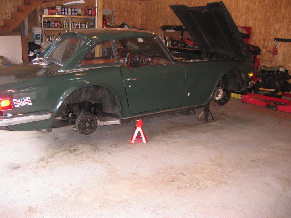

Hi Randy! How have you been? Thank you for posting the photo of your 2 post lift. I am in the process of selling my home here in Illinios and scouting property in Sarasota florida, Kentucky and Tennessee just south of the smokys. I wanted to design my new shop with the car lift in mind. I decided on the 2 post as most of my work seems to center around suspension, body and wheel work. After looking at your photo of the 2 post i can see it really does not take up all that much space! I will have have a 5 car garage such as i do now so the 2 post makes the most sense to me. Thanks again to everyone!75 TR6 017.jpg for taking the time to post your comments and nice photo's! I just dread packing....but it will be worth it! Michael. These jack stands will no longer do! What is not pictured are the 4x4 wood blocks i always use for a back up!
