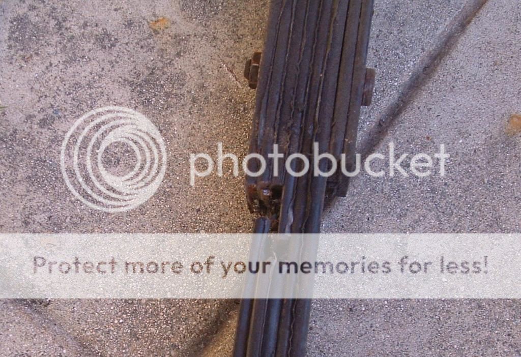

I'd say most likely it is an issue, a broken or seriously sagged spring.
DSCF0016_crop.jpg~original
It is not uncommon for them to sag on the left after years of use since most of the miles have probably been with just one passenger - but Âľ" is a lot to attribute to old age so I agree you should look for breaks in the spring.
They may be hard to see - likely won't be as dramatic as Randall's photo with the spring still in place and the leaves still clamped together. Additionally some of the breaks may be concealed behind other components. When mine broke I thought I was looking at a single break until I started taking things apart - then I found several leaves broken. I suspect that once one breaks others soon follow.
I don't know that it is 'best practice' but I had read that some had issues with ride height using replacement springs so I got a used spring and just replaced the broken side (passenger side like Randall's). I was able to sneak in and replace it without disturbing the diff or the other spring.
I ended up with a level ride as the replacement spring was about the same age as the one I did not change but I am sure that if going with new springs you will want to do both sides.

Like the 2 spacers like in Randalls picture of the broken springs. I did that and it didn't seem to help. About a 1" difference from rt to left side.

Of course that pair of spacers only adjust by the thickness of two leaves - not much help if you've got an inch of sag. I don't consider broken springs to be okay and a Âľ to 1" difference is not my idea of acceptable aging.
BTW - In case it isn't obvious, the spacers cause the side they are used on to sit lower (not higher). Possibly counter-intuitive until you recall that the springs are under the axle.
