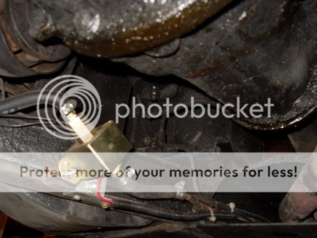

Does someone recognize this fuel pump?

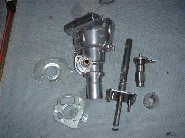

TR6 distributors do NOT have teeth. There is a slot on each side of the center shaft that will only fit one way in the drive gear.
Note the driven gear in the bottom right of this picture of my disassembled distributor.

TR6 distributors do NOT have teeth. There is a slot on each side of the center shaft that will only fit one way in the drive gear....
Right. But that dog drive goes into a gear that does have teeth, and that gear can be put in as many positions as it has teeth. That was my point: that someone might have put the gear back in the wrong position -- maybe just one or two teeth off -- and that keeps the distributor from moving as it might need to, especially when you factor in tach cables and such.
Absolutely correct!! A very good point and taken well on my end Andy. That could be possible, but looking at his pictures, that looks like he's just about at the area where my tach cable gets tight as well, although I am slightly further clockwise of his. I've had to fiddle with the cable from time to time when swapping distributors around.

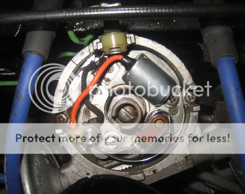

<span style="color: #000000">Anders- Here is a photo of my dizzy.
I set the points at .015" and my spark plugs at .025"
When functional; my car runs very well at these settings
and starts instantly..
The Triumph experts will jump in and explain to you the errors
I have made in my dizzy set up but it's a decent photo
as a starting point for you.

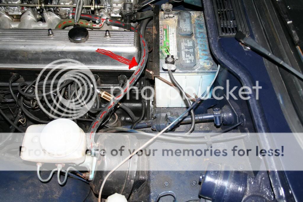

- Cut away the hose running from valve head cover to carbs and brake servo. Which messed up the vacuum in both the carbs and the servo (picture).
