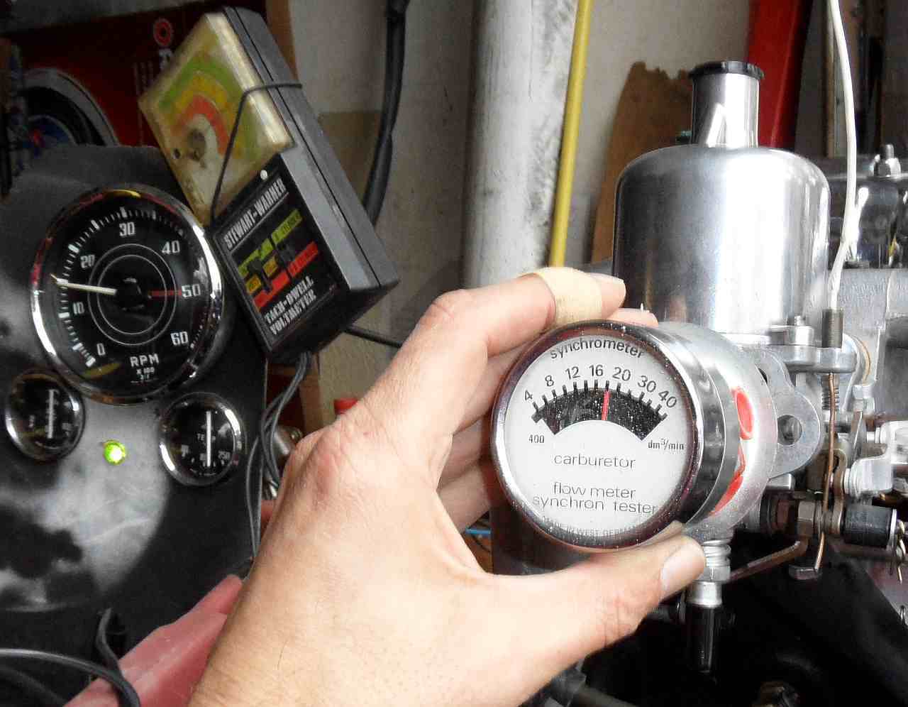

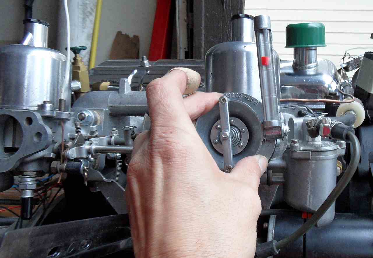

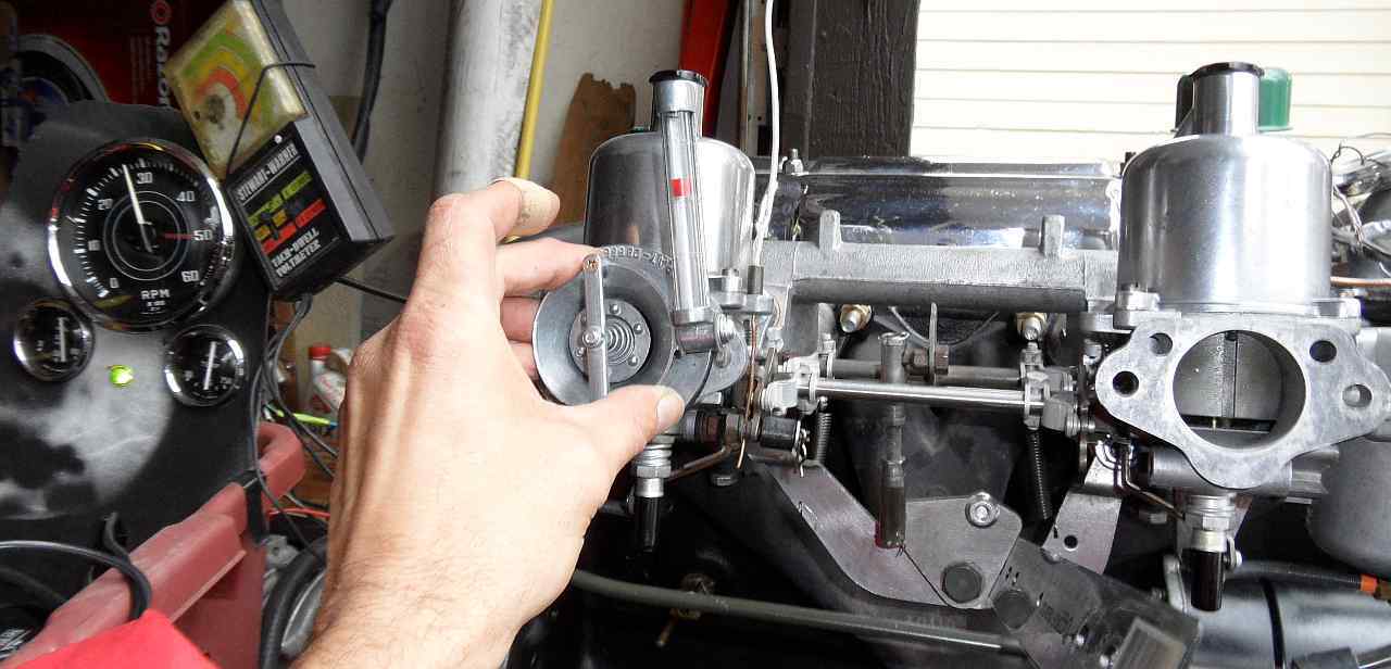

Are you sure the throttle position isn't moving between checks? I wedged a ruler in the linkage to be sure the position was the same for each carb and was as if I was pressing the actual pedal. How far off are they? Is it possible that your uni-syn is defective? Have both butterflies been centered? With the carb off, and the idle backed out, you should see almost no light coming from around the disc when held up to a light.
One of mine wouldn't idle down because the body of the carb was out of round, so the disc couldn't quite close. I filed a little off the disc, so it could, and now it idles fine.
