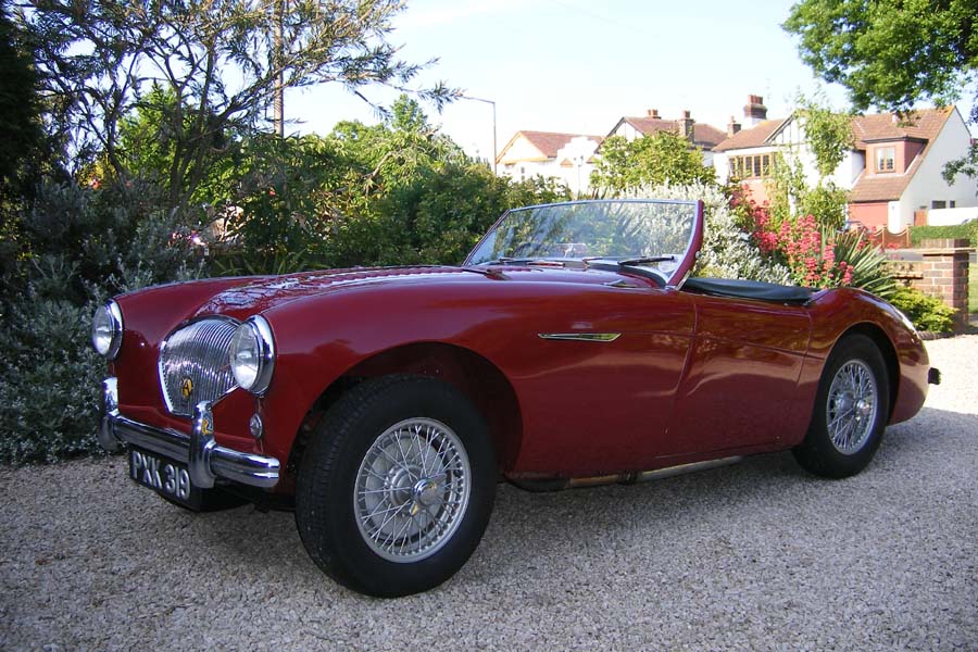

P.S. have attached a pic of the car.

Nice looking car. I,m sure you are anxious to get it running properly.
