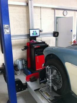

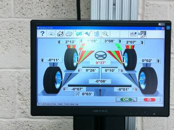

Ive just finished my bj8 and took it to my local scooby specialist who set up my wrx on their laser alignment, we managed to get the front from 2 to zero using the offset bushes, also squared up the rear axle which was also out (amazing the few millimetres of moving the axle on the clearance hole on the spring bolt /axle mount makes) we then set the toe in and then adjusted the steering wheel to centre.
I had previously set it up with a rough straight edge, amazing the difference to drive now, well worth doing. Will post a pic later when not on iPad as it won't let me load files.

if you loosen the u bolts you can move the axle, with a pry bar, but only as far as the clearance hole on the axle mounting bracket lets the axle move against the spring, ie there is a bolt holding all the leafs together on the spring and this sits in the hole on the axle bracket, with slight clearance between the bolt and hole. This can make the rear axle sit again 2 deg to one side, see next pics after we squared her up.

we first got old rusty on the ramp with laser plates on the wheels, then squared up the rear axle to show the 0 deg on the screen, the front offset bushes were set centrally as the screen shows with 2 deg, we then took it off the alignment and set them fully on the horizontal plane giving 0 deg, the centre steering then set to 0.18 which i am told is acceptable in modern cars
