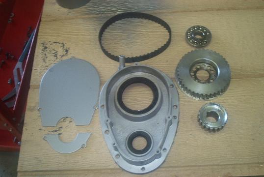

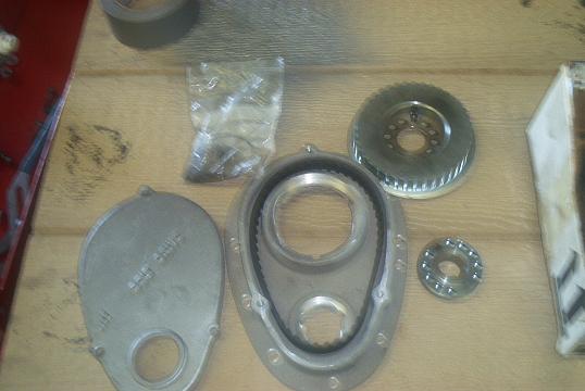

Ok, you guys wanted pictures, the first picture is the one that was on Mike's engine, that had almost sheared the dial pin in the Swiftune 1380, notice it has a two piece front cover to allow you to change cam timing. The second picture is the one Eric sent me to go ona got rod Mini engine, it has a solid front cover, so no easy cam timing changes, I also noticed he didn't have the bottom crank belt pulley in his box, he bought it off Ebay, unless he has the crank pulley in his stuff at home, this was even more money wasted. I doubt this one on his engine, even if he has the pulley. The dial pin looks to fit snug on this one, so who knows maybe the other one was just machine sloppy. They made a adjustable timng timing chain kit that used dial pins instead of the vernier style with the bolt, that slide for adjustment, I know I've heard the dial pin unit were removed form the market at most vendors because of failure, while the only Kent or Rollmaster vernier failure I ever saw was user error, I used the Kentand Rollmaster verniers for over 20 years without a failure, I always after degreeing the cam, remover each bolt one at a time, clean the thread and locktitie them, never had a problem, recommend both the Kent and Rollmaster verniers.

Here's the other one, wouldn't let make a second attachment.
