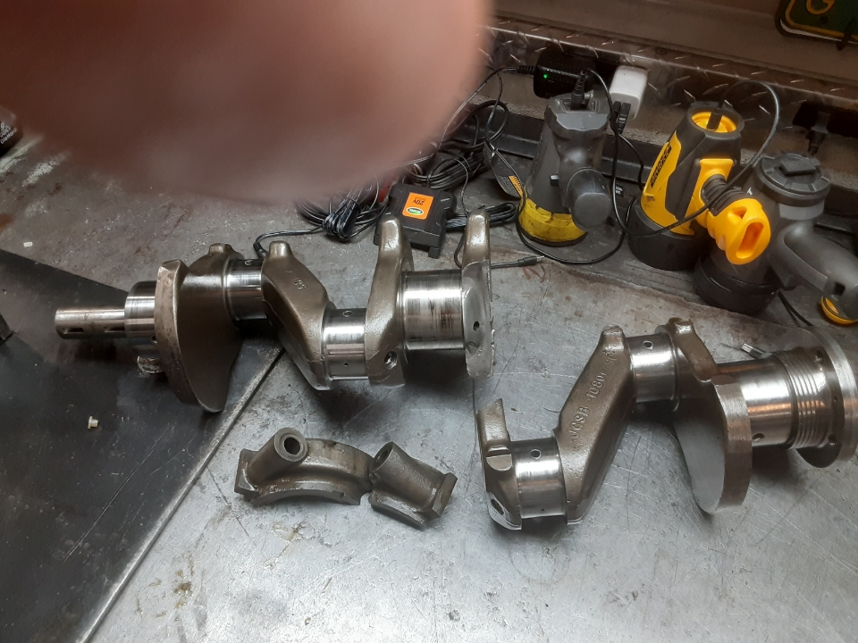

Even though it seems like a crank "just breaks" all of a sudden...it is always a fatigue fracture that kills cranks. You will see the tell tail "beachmark" striations on the face of the broken parts. Failure will always begin at the corner of one of the bearings, where the stress is concentrated. If you want a crank to live the longest, machine a large radius in all the bearing journals, and then have the entire crank shot-peened. Fatigue only happens in tension...and almost always at the surface of the part. Shot peening compresses the outer layer of metal, leaving it in compression. That way the surface sees less tension, so less chance of fatigue starting.

McT...because forging is a non-precise impact process, you get a lot more imperfections than in most well-cast cranks. The difference is that a bubble like you saw will kill a cast crank, but it can live a long life in a forged steel crank. Of course, if you are racing and need rock solid reliability at high RPM, then you want to select a forged crank with no visible imperfections, even though this is difficult with most forgings.
Triumph nitrided their cranks. This process drives a layer of nitrogen into the surface of the crankshaft...but only about .002" deep. It does little for fatigue resistance, but really reduces wear. The older nitriding process is outlawed by the EPA, as the crank was dipped into very caustic chemicals. The modern alternative is called Ion Nitriding. In ion Nitriding the parts are place in a sealed container and electrified while in a nitrogen gas. The parts light up like a neon light as the nitrogen bombards the surface and becomes impregnated...again only .0025" max into the steel.
From what I have seen, the stock TR rods will long outlast the crankshaft. But, anything to lighten the rods...and pistons...can only help the crankshaft. Rods, being steel, can benefit from shot-peening. Balancing the assembly within a gram also goes a long way to reducing loads on the crankshaft, as it prevents uneven bearing loads.

Got a pic at the autopsy note the broken main cap
