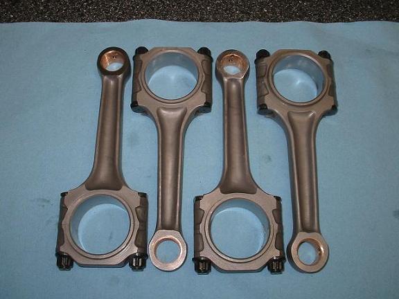

When converting the small end of an A series rod to a bushing for a floating wrist pin how is the pin retained? I’m assuming a custom piston with provisions for circlips is needed but I would like to know for sure.
