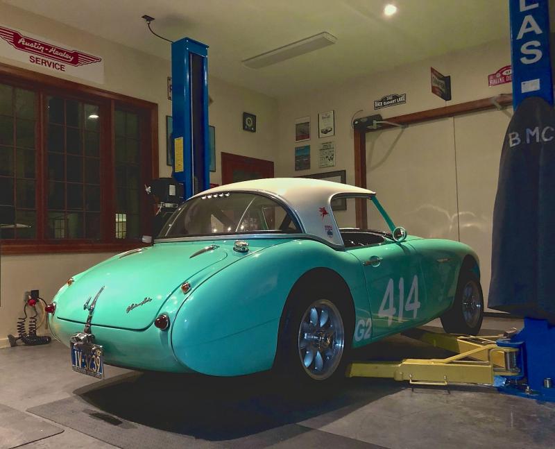

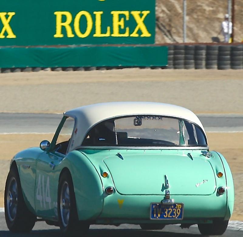

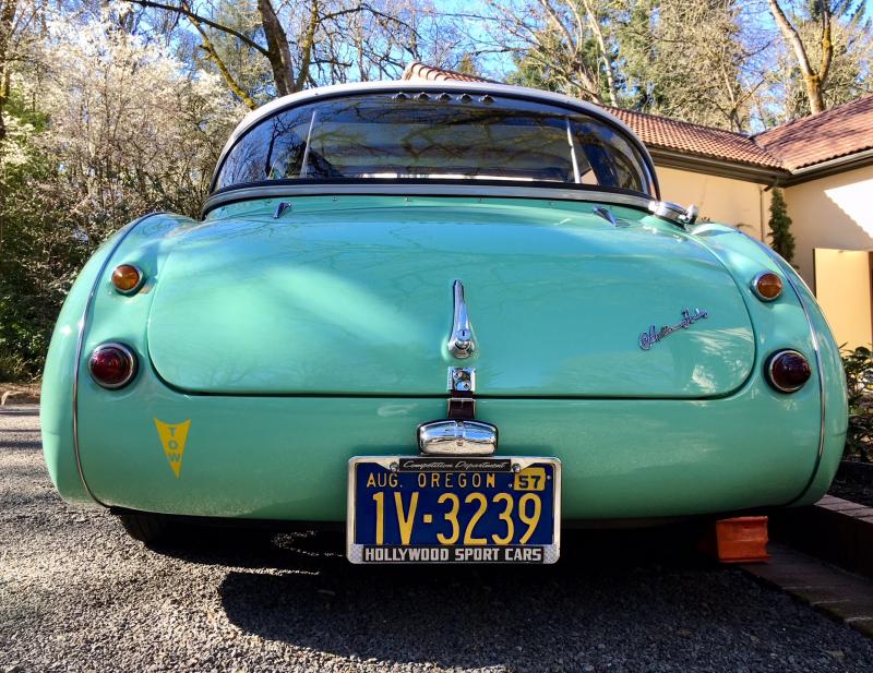

I had the AH Spares brackets and Sprite bumpers on a previous car but I prefer the complete bumperless look than I have on my current one. For those that don't wantto permanently fill in the holes for the bumper brackets, AH Spares and others sell oval shaped rubber grommets which press in.
I'm not sure the no rear bumper look won't attract attention from the authorities around here. If I go driving lights in the front that seems to trick the mind into thinking theres some kind of bumper up there.
Dougie’s looks way better with the holes properly filled than just with painted grommets, that’s just wrong .

Dougie , why the leather spare tire boot strap to hold the boot closed , is it just for safety reason in the event of a rear ender or is it a requirement for vintage racing ?
Yes, additional boot locking mechanism is needed in vintage racing.

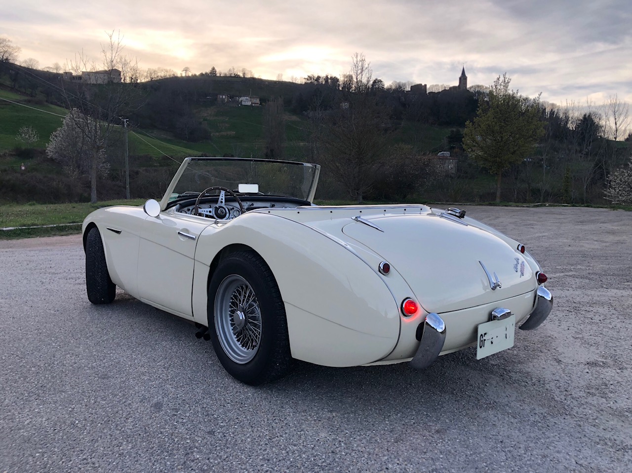

the brackets of ah spare or limora or moss have been slightly modified to stick as close as possible to the bodywork ... it is a complete kit
