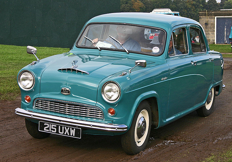

Hi All,
Well, as I previously surmised, many of the chrome parts on the Healey were also installed on other models. Hear is a picture of an Austin A50 using the same bumper pressing and profile as the Healey 100/6 through BJ8P2.
Based upon the facts that:
  1. Front and rear bumpers on the Healey and other models have the same profile.
  2. Most cars of the times could also be started by a crank handle.
I would not be surprised to find the crescent cut was made to facilitate the use of a crank starter handle in another vehicle.

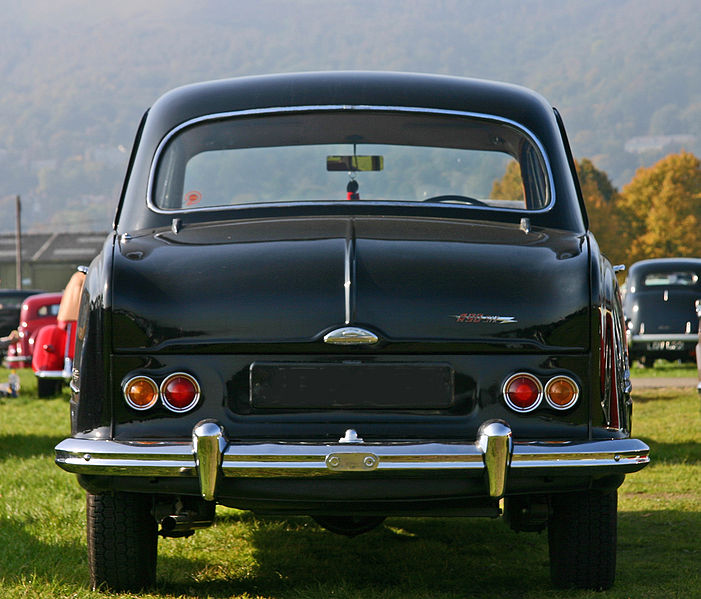

Or maybe it was to facilitate a plate light on an Austin A90 Westminster as below.
Pointing the crescent cut down on the Healey may have been a way to hide it in order to use the production part.
All the best,
Ray (64BJ8P1)
