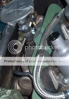

MIne is pretty simple Tulsafred. You can see in the photo on the left the copper line connected to the carb with a black vinyl tube. It hugs the valve cover, takes a left in front of the heater, turns down then fastens to the vacuum advance with another vinyl tube. Now that I look it in the photos it probably would not hurt to put a little shrink tubing on the copper tube running near the starter solenoid.
Not sure if that is stock; just the way it came and it seems to work.
Charlie
Hi Charlie,
Thanks for the pics.
It looks like someone used rubber vacuum lines to make a connection to the vacuum advance unit and the carb/manifold. On mine these are both threaded, presumably compression, fittings.
Since the oil pressure line kit has the correct fittings and copper tube, I really at this point just need the routing.
So on yours the line runs along the valve cover back to the heater box. How does it run there? Is there a attachment fitting to hold the line in front of the heater box or does it just run unsecured?

HI Fred. That's right, the copper tube is just pushed into the vinyl tubing. No clamps or anything. I don't know...seems to work. The tube just lays there. No fittings. Now I can't say that's typical or "correct". Someone with a pristine car can tell you more.
I suppose you could cable-tie it to the pipe coming out of your heater if you feel it should be tied down. I have that pipe but it is not hooked up at the moment. I am not sure whether my heater core is any good and I don't want to find out the hard way, so my valve is shut off.
