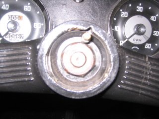

Fun time shopping at Sears on Friday, now I've got a few more tools handy (and an extra set to put in the Tunebug). I picked up the socket for the steering wheel nut. I'm assuming I need to remove the little brass sprung plunger-like object that the horn push connects to -- shown in the top of the wheel center in the attached picture.
Does this just unscrew? It looks like you can't get the wheel nut to turn until this bit is removed.
Thanks, Ray. I admit, I hadn't even tried that.
I was prepared for all sorts of trouble pulling the steering wheel off, days of PB blaster, that sort of thing. Nut came off easily, and the wheel just pulled straight off. Looks like a PO greased the splines with something. Took no effort at all.
