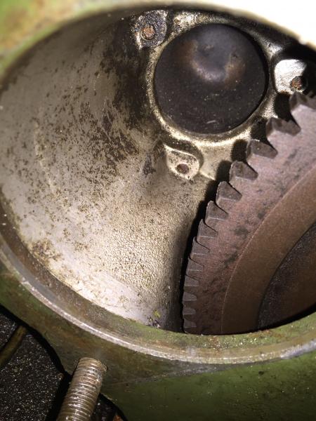

How does the flywheel ring gear look? Are the teeth sharp and crisp, or are they rounded and warn? When the starter is removed will the starter drive pull all the way in? If so find you a piece of hard wood about the size of a hammer handle.

BlueMax: The flywheel doesn't show enough wear that it made me worry:
attachment.php
The 2nd starter drive will pull all the way in and all the way out.
