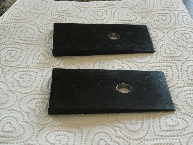

I lowered mine with wedges I had made. You could place a different angled wedge in each side to adjust the lean.

markberry said:
Hey Kevin,
Mark,
How did you make the taper on the wedges? Belt sander or mill?
What are the dimensions?
Thanks
Look like nice work don't they.
Hi gerard,
I had 4crawleroffroad.com in San Jose make them for me. they are four inches long, two inches wide, 1/32 or so thick at the thin end and 3/8 thick at the thick end. the angle works out to be 4.5 degrees. I marked the spring locating pin holes with the wedges in place where I wanted them then removed them and drilled them on a drill press.
The formula you would use for figuring the amount of lowering on a bugeye is: The length of the spring(from the forward mounting holes in my case)to the attachment point on the axle housing divided by the length of the wedge(four inches in my case)
X the thickness of the wedge at the thick end + the thickness of the wedge at the thin end.
Or: Total drop = (spring length) X (T2-T1) / (Wedge length) + T1.
I used 16.5 inches for the spring length then played with the above formula to get the amount of drop I wanted. I then sent my dimentions to 4crawleroffroad for manufacturing.
Let me know if this helps. I can try to find the reference for the lowering formula if anyone needs more clarification.
Mark
