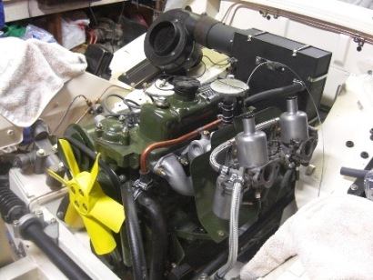

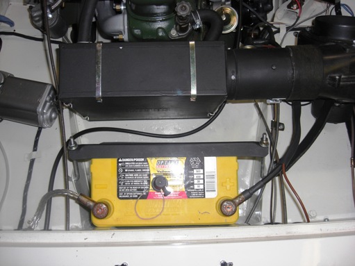

The heater valve flapper for the "fresh air" is the same size as the tube that goes between the blower and the heater box. See if these photos are any help.
Scott in CA
