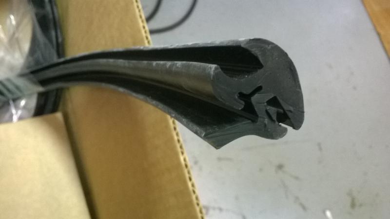

Interlocking original style seal or one with a lock strip? Is it one continuous (fused) loop or single rope style that must have the ends trimmed to fit?

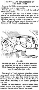

There are two basic techniques. One requires placing the rubber on the glass first, and using paracord, pull the lip of the deal through the window opening. I've never tried this with fiberglass. the rough, and more fragile edge of the fiberglass may not work well. (See attached explanation)
I have not worked with fiberglass hardtops but I have installed glass in steel hardtops and several windshields in various British cars. In general I use the method described by Gerard. The only thing I do differently is to use KY Jelly for the lubricant.
If this is a T piece rubber gasket with a filler rubber, then the method I used to do my Sprite hardtop should work . Warm the seal in the hot sun. Then put it onto the hardtop first from the inside. Then run a strong cord of twine around the edge. Set glass in the bottom of the seal from the inside and use the twine to pull the seal over the glass while you keep outward pressure on the glass. The hard part for me was setting the strip. Use a water based lube (J-Lube is a farm ob lube) and the plastic glazing tool ( VB has it) and push it in. Somewhere on the web there is a good description on how to do it on an Mustang. I am on my Cellphone now so I can not find a link.

The original seal did not use a (separate) lock strip. Instead, it has an interlocking lip that must be tucked in after the glass is in place.
