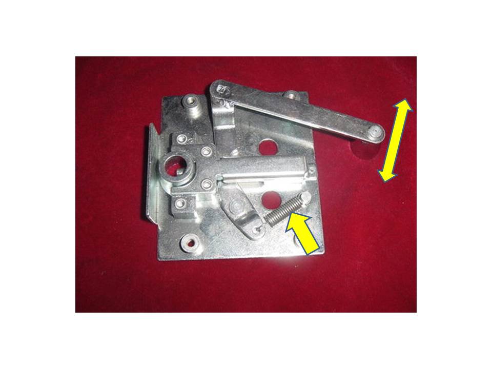

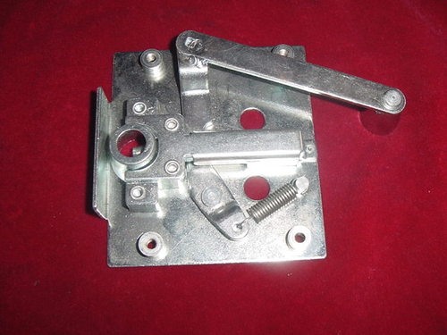

I'm trying to eliminate as many rattles in my Bugeye as possible. One source is the door latch assemblies like those shown below. The door latch works fine, but when the doors are closed, the handles are incredibly loose and flop back and forth causing a minor but annoying noise when I hit a bump in the road. I know that the spring shown in the lower right is supposed to keep tension on the handle when the door is closed and thus prevent the handle from moving up and down, but there's still quite a bit of side-to-side play. Has anyone ever found a way to prevent this?

Just to clarify the problem I have, take a look at the image below. The spring labeled with the single-ended arrow keeps tension on the handle when the door is shut, thus preventing any loose movement of the handle in the up and down direction indicated by the double-ended arrow. The looseness that I'm referring to is in a direction perpendicular to the normal motion of the handle. I.e., towards and away from the driver, not up and down.
Seems like the solution would be to drill out the pivot and refit it with a top hat bushing and wavy spring washer.
