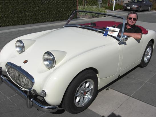

The steel bonnet has angled adjustments to control the angle of the vertical portion of the fender. To make mine fit ( a steel one) I adjusted the angle brackets, reset the rubber bumpers next to the sill, and shaved the gasket located at the top of the firewall (all reproductions seem too high). this is what I ended up with. If I ever go to a forward tilt bonnet (my first BE had one), I would use spitfire latches. Also use a real production hinge for the forward tilt, as the one I made myself, rubbed sheet metal when opening.
Scott in CA
