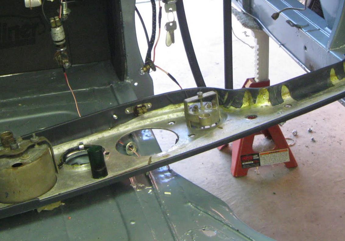

Anybody care to pick up my slack and show the guy a picture of what one of the minor gauge lights looks like?
I've got your back Randy. (Although I'm jealous that you're at the beach).
Here is a cropped photo of the back of my dash. You can see the fuel gauge with a round cylinder on the top. The light plugs into that cylinder. I probably have a better picture at home, but that's about the best I can do here at work. Hope it helps.
That's what I'm talking about! You can even see through the "windows" in the gauge housing (close to the dash) where the illumination floods the interior of the unit.

I totally get what you guys are saying but mine is apparantly different. I neither have a wire for the socket or the bulb socket holder on the gauge. Here are a couple of pics. It must have had it originally because I see the slotted blue plastic strips around the gauge to let the light in. photo 2.JPGphoto 1.JPG My gauge also has two mounting posts as you can see.
The bulb socket is on the metal piece that holds the gauge in the dashboard. It's not on the gauge itself.
